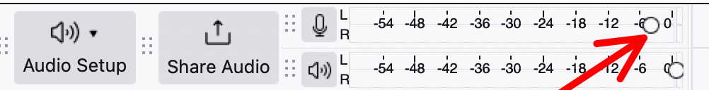

(Next time) increase the recording level (see picture below)
and / or
use the “Normalize” effect /Effects → Volume and Compression → Normalize)

I adjusted the recording level as you suggested and it seemed to work; today it quit working. Also in the track display how can you adjust the height of the waveform? Also the the volume conttrol of the USB turntable make a difference?

There is a “trick” for checking the peak levels: Run the Amplify effect and it will default to whatever change is needed for “maximized” 0dB peaks. For example, if it defaults to +6dB your peaks are currently -6dB.
If you just want to check without amplifying, you can cancel the effect.
…There was an Audio-Technica USB turntable with “famously low” output.
That’s not always a bad thing… Records don’t have a fixed levels, or a fixed maximum level like CDs. If the signal from the record is to “hot” and the digital levels “try” to go over 0dB, the analog-to-digital converter inside the turntable will clip (distort). On the other hand, low digital levels aren’t a problem (1) and you can run the Amplify effect after recording.
Digital amplification is a lossless process so it doesn’t hurt the sound quality.
A lot of USB microphones without recording volume controls are “calibrated low” for the same reason… So you don’t get distortion with loud sounds.
Also the the volume control of the USB turntable make a difference?
Usually no, but there’s no harm in trying it.
