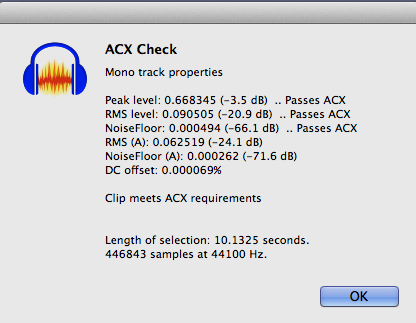

That seems to work. I applied simple audiobook mastering and then ACX-Check. You should pass noise by at least -65dB and this clip does that (-66dB is quieter/better.)
The presentation is a little sharp, crisp and “essy.” I applied DeEsser and it seemed to help.

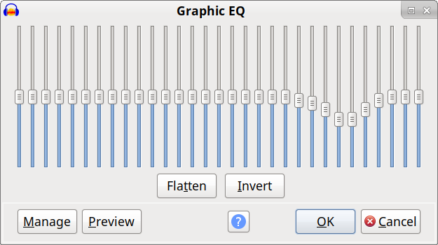

The NT1-A USB has a “presence boost” in the range 2 to 10 kHz, rising to around +7 dB in the 5 to 6 Hz range.
This does not suit all voices and may overemphasize sibilance.
That presence boost may be countered by applying Equalization to reduce that range.
That’s very interesting. Will give it a go - thanks!
