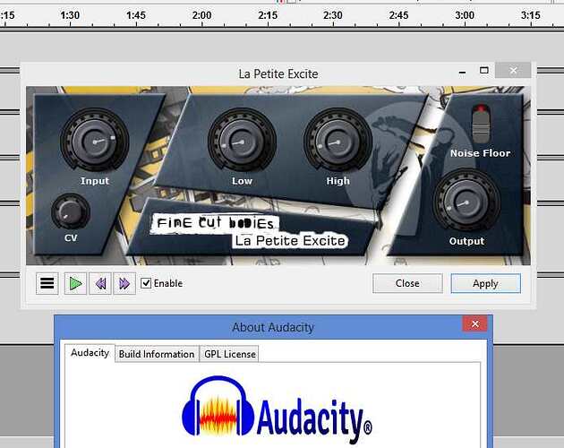

A free (simple) expander plugin called “La Petit excite” does a good job of enhancing bass …
alternatively there is a free (complicated) plugin called ToneBoosters FLX which can be set to expand bass …
[Audacity does not come with an expander effect]

Yes, sorry for the vague description. Its a recording of a live broadcast, I have downloaded “La Petit excite”, can you adivse me how to import it into Audacity and apply it. Many thanks for the responses ![]()
If you’re using the current 64-bit Audacity 3.1.3 for Windows, you will need the 64-bit VST2 version of the plug-in.
For installation / enabling, see: https://manual.audacityteam.org/man/installing_effect_generator_and_analyzer_plug_ins_on_windows.html#vst_install
“La Petit excite” is a [VST] plugin which when installed in Audacity appears on the effects menu, (along with the native effects).
How to install VST plugins in Audcaity … https ://manual.audacityteam.org/man/installing_effect_generator_and_analyzer_plug_ins_on_windows.html#vst_install.
