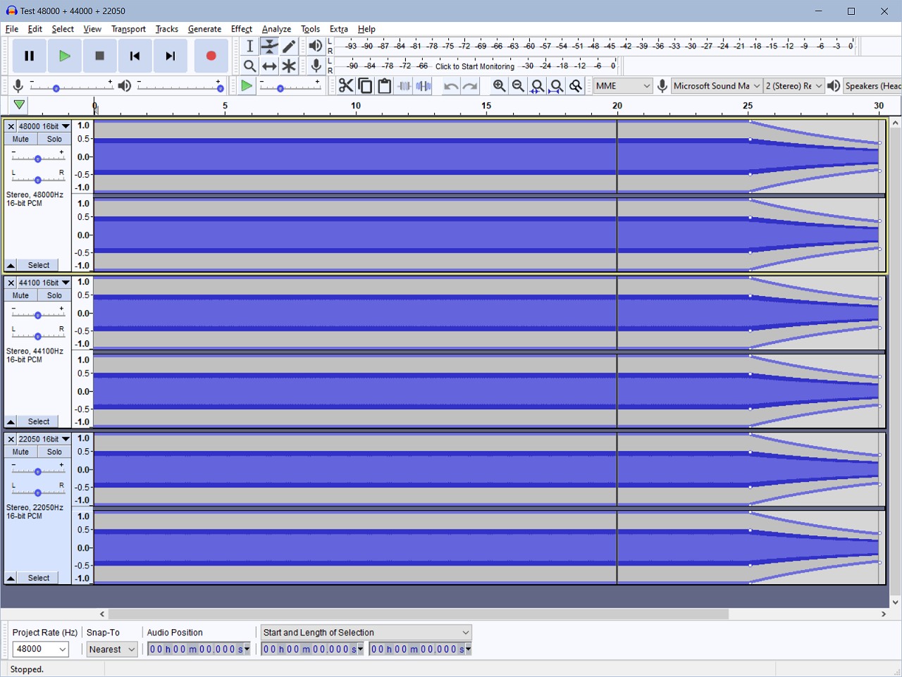

Some pictures to help show the issue…
The first picture is the aup project in v2x. Note that all clips line up, and they each have the same envelope that continues to the end of the clip.

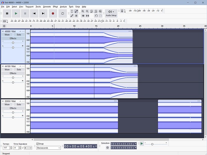

The second picture is just after opening/importing it into v375. The short clips have all shifted left or right, depending on their sample rates (the app’s default settings were 32khz at 32bit for this test). And the envelopes have also shifted, and no longer line up with the clip ends. Also of note, all tracks are 16bit, but the 48khz track is the only one that imported as 32bit. It didn’t matter if the 48khz track was first in the list, or second in the list, it always comes in as 32bit, but the other tracks come in as 16bit. I did an Amplify +9db then an Amplify -3db for all tracks, and only the 48khz track was not clipped from this, so it really is 32bit as it says it is.
