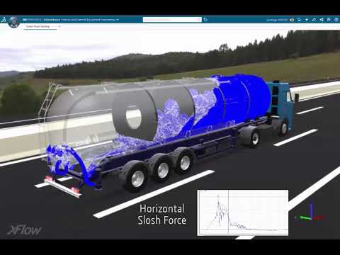

There’s no good illustration for this (and it’s too late to shoot one myself). Watch the first half of this video.
That speed of liquid slosh really likes that truck. If you change the truck length or almost anything else, the speed of slosh will change.
Now picture bass notes sloshing around in your room. Some notes will really like building up by the china closet where others may like that one spot by the credenza.
Back to that truck for a second. If you could shake it fast enough, you might get two waves building up instead of just one long one. That’s your room responding to booms an octave up. You might also get two places in the room where that tone builds up.
