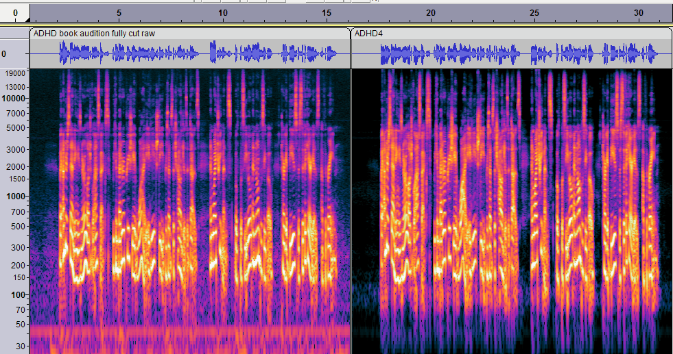

The EQ on your Raw audio is atypical : there’s a big dent in it from 800Hz to 1800Hz …
red=raw, green=good
It’s atypical enough to be due to talking into the wrong side of the microphone … https://youtu.be/iyQ4nJgGHZk

Hi Trebor, I’m just wondering if you have any ideas of what could cause the gap in my audio? Would it be a mic fault that it is not picking up that frequency?
I haven’t edited in the format your video clip is showing, but looking at spectral view I can see the gap you’re mentioning, and you had mentioned it previously when I had made another post. I can’t really afford a new mic right now and am mid process with this book. I’ve tried looking at the microphone settings on my computer and in audacity and don’t see anything that would be interfering with that frequency or changing the audio at all. The only thing I have done with the input is recording at 75% input level in the one I posted there, and now I have brought it up to 85% for another take to see if that works better.

I tried a different setup at a desk with a blanket overtop, as before I had the mic in a cardboard box with some foam (not proper acoustic foam though, I know) and a blanket overtop (thick duvet). The new setup at the desk I have a quilted blanket on the desk with thin foam around, and it has a shelf above that makes a square shaped hole where i have put thin foam around as well as a pillow behind the foam on each side and another quilted blanket behind (against the wall) and around the foam/pillows. then I draped my duvet over the shelf and hanging down behind me. I was getting echo before adding the duvet but with it there it sounds better. I’m still not getting the sound I would like and it is still missing that frequency, but I’m wondering if my mic is just crappy, or if it isnt working properly. Unfortunately I’m sure it is past warranty. It is an Aluratek Rocket USB mic.
I’ve never seen a mic fault take a bite out of the spectrum.
It could be the acoustics of the box you’ve put the mic in, or echo-reduction processing “enhancement”,
(or that you’re recording from the computer’s internal mic, rather than the external one).
It shouldn’t be any of those! I switched location with a new setup outside of the box and it looks exactly the same. I don’t have any known settings doing any kind of enhancement on it, and I am definitely recording from my mic, with my computer at a distance so I don’t pick up the computer “hum”. I check every time that the audio is set up properly to come through my mic.
I followed the link you sent about audio enhancements. There are no options for this mic in settings for audio enhancements on input. The only option I saw was on output, where I turned off all audio enhancements. I tried recording again and it still looks the same. There is no options to adjust settings on the microphone input other than volume.
I was trying to find examples of what it sounds like, (without success),
and noticed it has two sensitivity patterns: you want the cardioid pattern.
I do have it on the cardioid pattern already :frowning:
