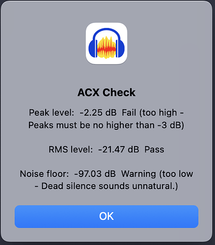

Thanks for telling me about the Audacity ACX Plug=in! I tried it out with this file, although I’m sure I need more help. Question about WAV files… I usually record, then export as MP3 (with ACX settings like mono, 192 kbps, 44100 Hz). Can you explain at which point I would need it to be in WAV? Do you mean, when I’m saving it to work on later? Thank you for your help.

“about me” sounds much better: no conspicuous processing artefacts.
Save (export) everything in WAV and then convert to MP3 ONCE as the last step. You can also save an Audacity AUP3 project but that may not be necessary with an audiobook. But still make WAV files. WAV files are “simpler” and occasionally AUP3 files get messed-up. Of course WAV files aren’t completely foolproof either so it’s a good idea to keep back-ups. If “the worst” happens you may have to start over! :frowning:
As you may know, MP3 is lossy compression. Information is thrown-away to make the file smaller. It’s not “terrible” and often sounds identical to the uncompressed original BUT when you re-open the MP3 in Audacity it gets decompressed. If you then re-export as MP3 you are going through another generation of lossy compression and SOME “damage” accumulates.
I understand that ACX has started inspecting MP3 quality. We should also remember that if you edit and re-export a 192 constant quality ACX Submission it’s not 192 quality any more—and you can’t back up.
