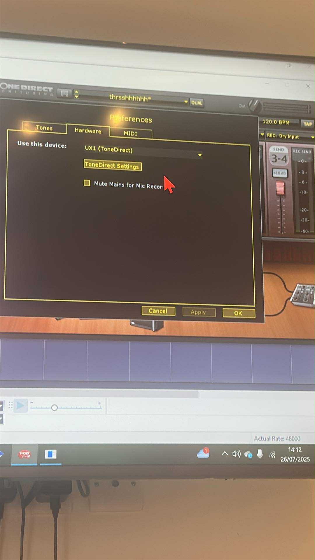

I have configured a POD farm 2 plug in to the effects (as my problem was occurring before and I thought doing this was the answer but it wasn’t)

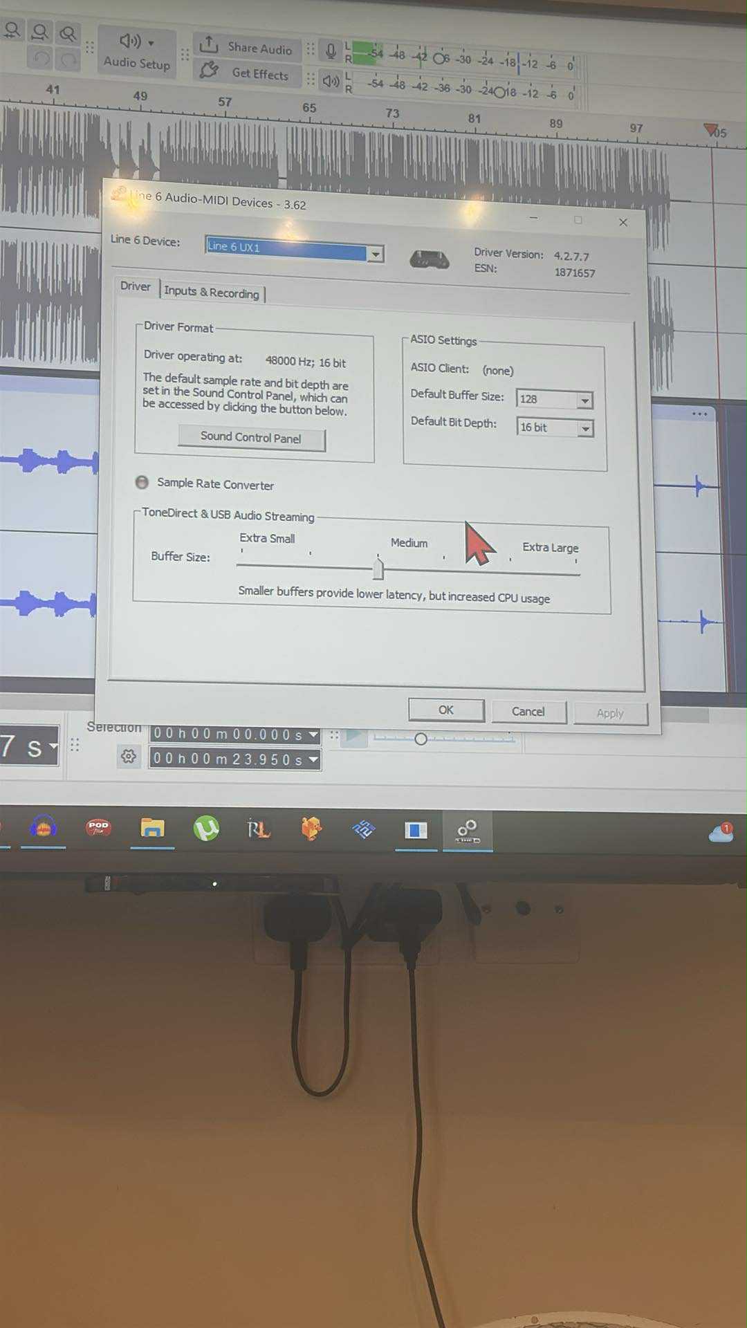

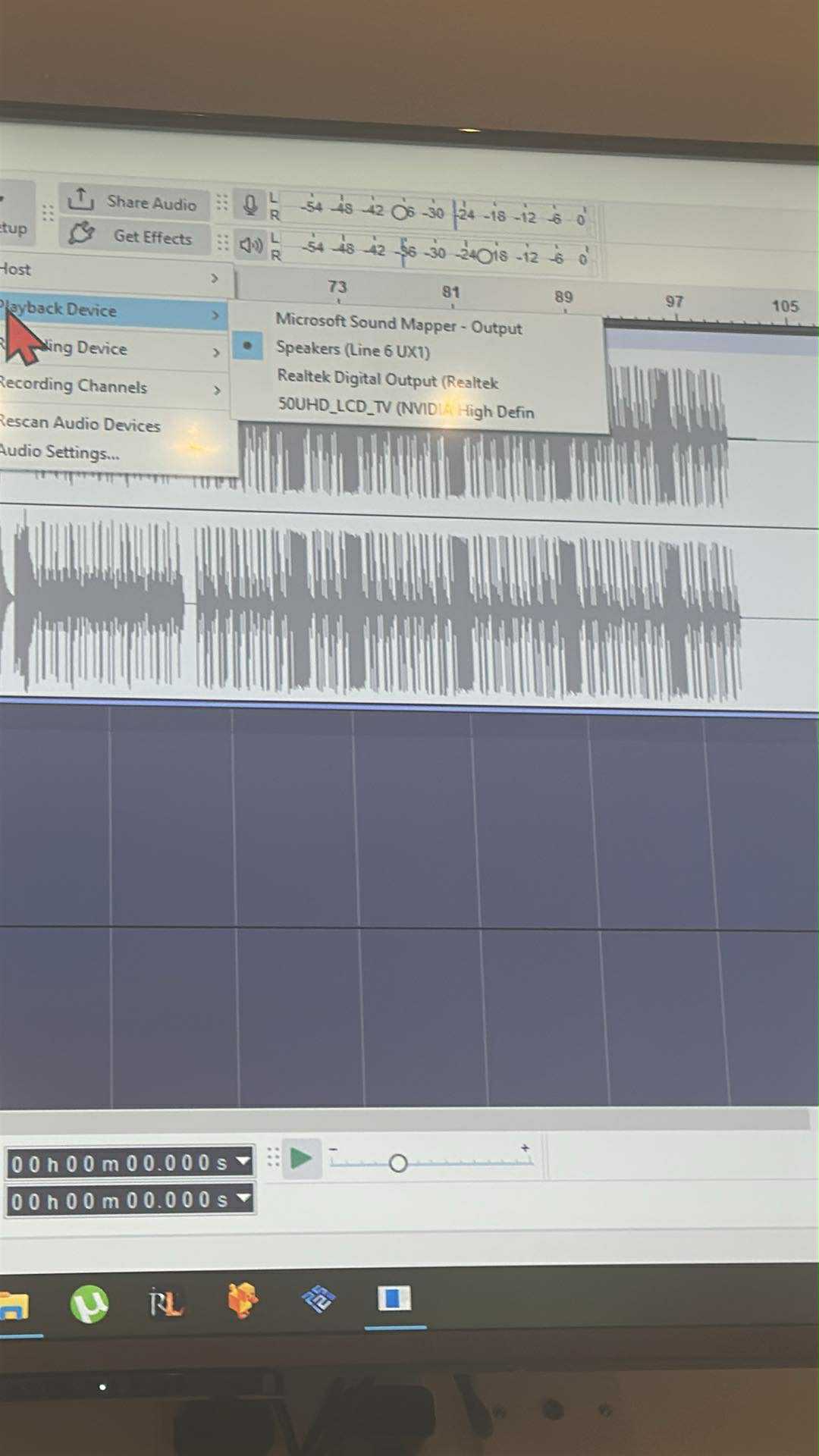

Please excuse the photos and videos I’ll attach as I was sending them to a friend as he uses audacity and I thought he may be able to help but here we are!

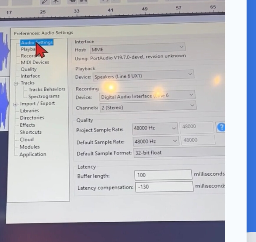

Here’s what’s being used on my audio settings mate
That thing you said is an option under the “host” option, I tried that option but nothing changed but I haven’t tried it in relation to what you’ve said so I will check that out thanks
