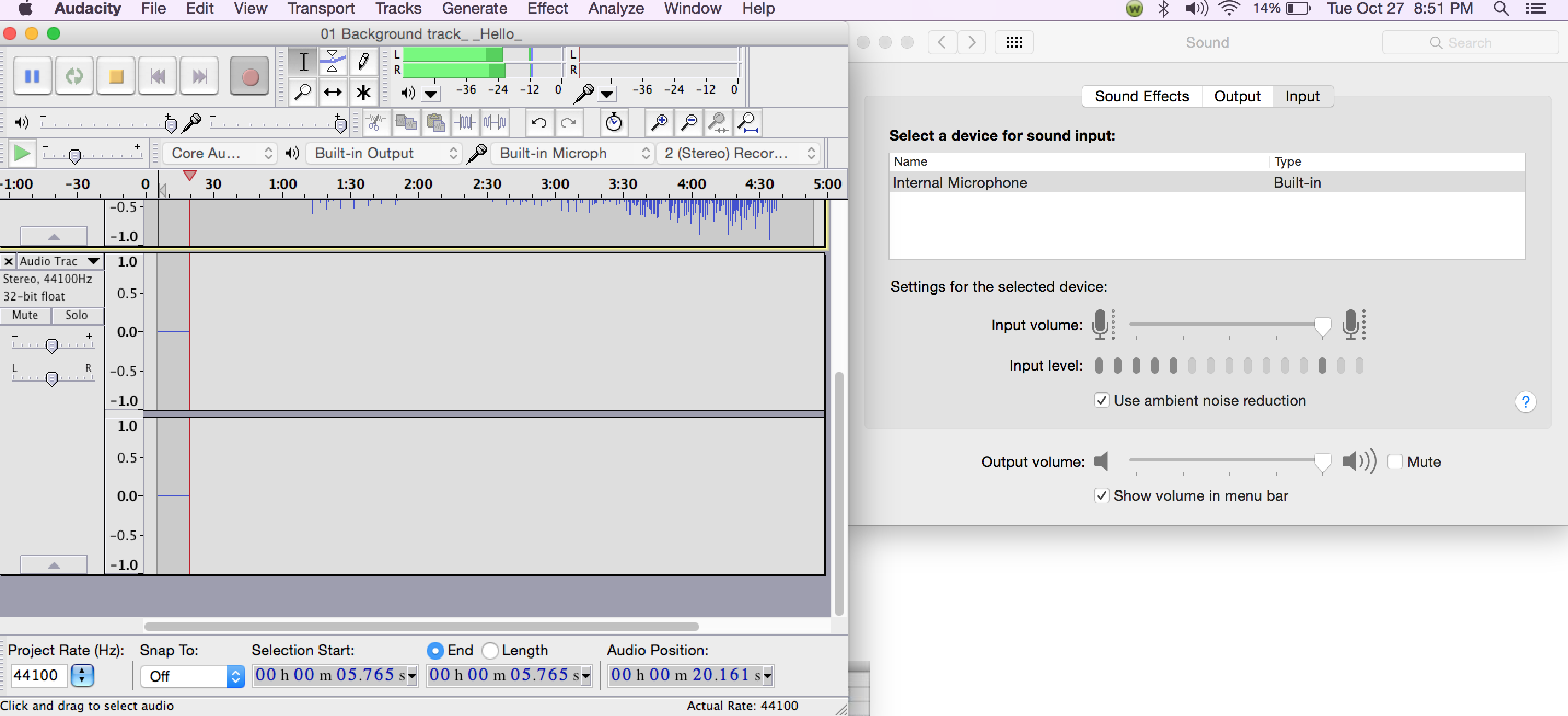

I am trying to record myself on Audacity (2.0.6) on my Macbook Pro (10.10.4) while playing a track. The track plays fine, but the voice isn’t recognized. I’m not using an external mic.
I went to Sounds and ensured the Built-in Mic feature is active, as well as on the Audacity screen, but no success. What am I doing wrong?
I’ve attached a screenshot.

Try a simple voice recording with no other tracks present. If you only record a flat line, you could restart Audacity, or you could charge the battery, in case the mic gets disabled on low power.
I don’t see any other clues from the attached picture. Sometimes, it can help to open /Applications/Utilities/Audio MIDI Setup and make sure the channels and sample rate of the input device matches with Audacity (so in your case set 44100.0 Hz, 2-ch in Audio MIDI Setup).

Could you try the mic in another program? Just to see if it works.
I’ve seen defective internal mics before, but these don’t show up at all.
