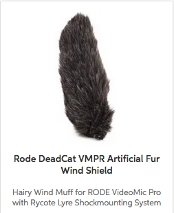

That thing on the end of the boom is the microphone fuzzy covering to help guard against wind noises. In the industry, it’s known as a “dead cat” for obvious reasons.
The goal is to do nothing at all to the desired sound, but eliminate wind and rumble. Those do very well. You can certainly get foam wind screens that work, too, but dead cats have a firm place in the audio people’s toolkit.
