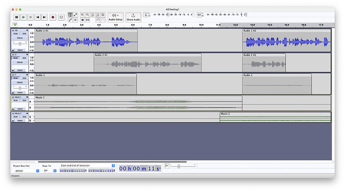

Hey thanks for that, it sort of worked but not fully what I need. The jingles as you say, I still need a bit of fade in and out, and also some of the audio will play quietly in the background whilst speaking goes on, so that solution doesn’t suit for my scenario. See image below as a quick example of me messing around so show what I mean…
Btw, whilst you’re looking at the screenshot. How the hell do I select only audio 2 from each of the track lines if I wanted to move just those parts? I’ve tried holding shift and clicking, control/command and clicking - something so simple seems to be beating me lol
Fade In/Fade out Effect at the beginnings/ends of the music, and select the parts you want fully silent and use “generate silence.”
As for the selection of Audio 2: I THINK grab it by the title bar, with your mouse, but I don’t know. I’m using an older, custom compiled version of audacity and I don’t have/use splits like that. I just paste into the existing track. It’s easier.

God dammit that is so much easier, just add in silence to all the tracks and no need to split them!
Yup! Now if you’re adjusting a WHOLE BUNCH of stuff over like an hour, then the splits are handy.
But for short stuff? Just add/trim the silences. ; )
haha there will be maybe 4/5 bits of audio going in, but most of it will be running in the background anyway, there won’t really be any periods of silence, I just wanted to know HOW to do it. Thanks again.
