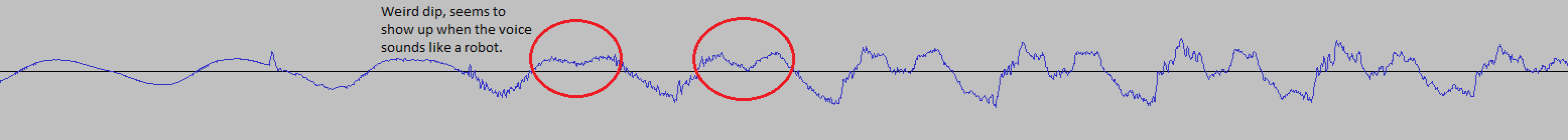

I’m trying to mod some voice files from a game to remove the subtle robotness in the voice. I think I’ve found what’s causing it and I’m trying to see if smoothing out the waves would fix it. Btw I’m very new to editing audio, sorry if I’m doing something dumb. Also I’ve attached the file and a picture and of what I think is making the voice sound like a robot.
Repair can be used to smooth-out short* sections, (*128 samples).
http://manual.audacityteam.org/man/click_removal_using_the_spectrogram_view.html
Let us know how it comes out.

I tried smoothing it but it didn’t really help, I played with the equalizer and compressor and got something that sounds better. I couldn’t get rid of all the robot sounding bits, but there less noticeable now. Thanks for the help, I think I’ll use this set up for the rest of the files.
