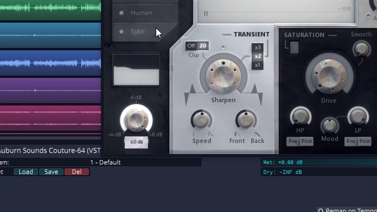

Dynamic range expander, e,g, the free version of Couture. (IMO 3x)
