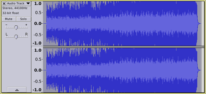

This is recorded too loud (irreparably damaged by distortion):

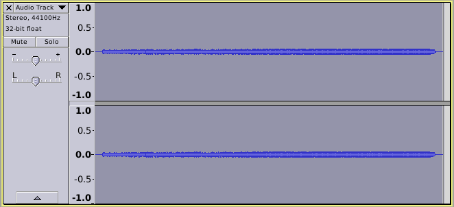

This is recorded too quiet (and will be unnecessarily noisy when amplified):

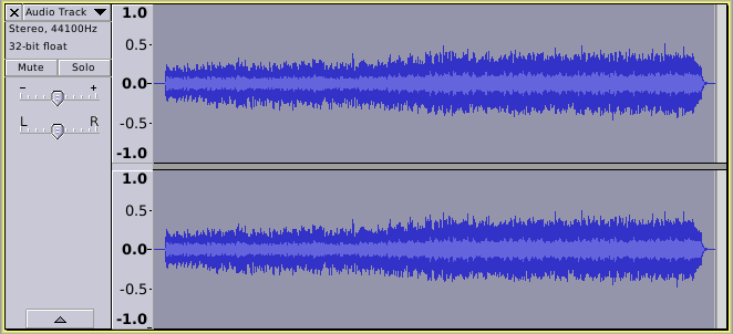

This shows a good recording level:

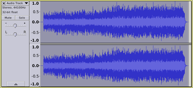

This is OK, but is dangerously close to distorting on the highest peaks:
