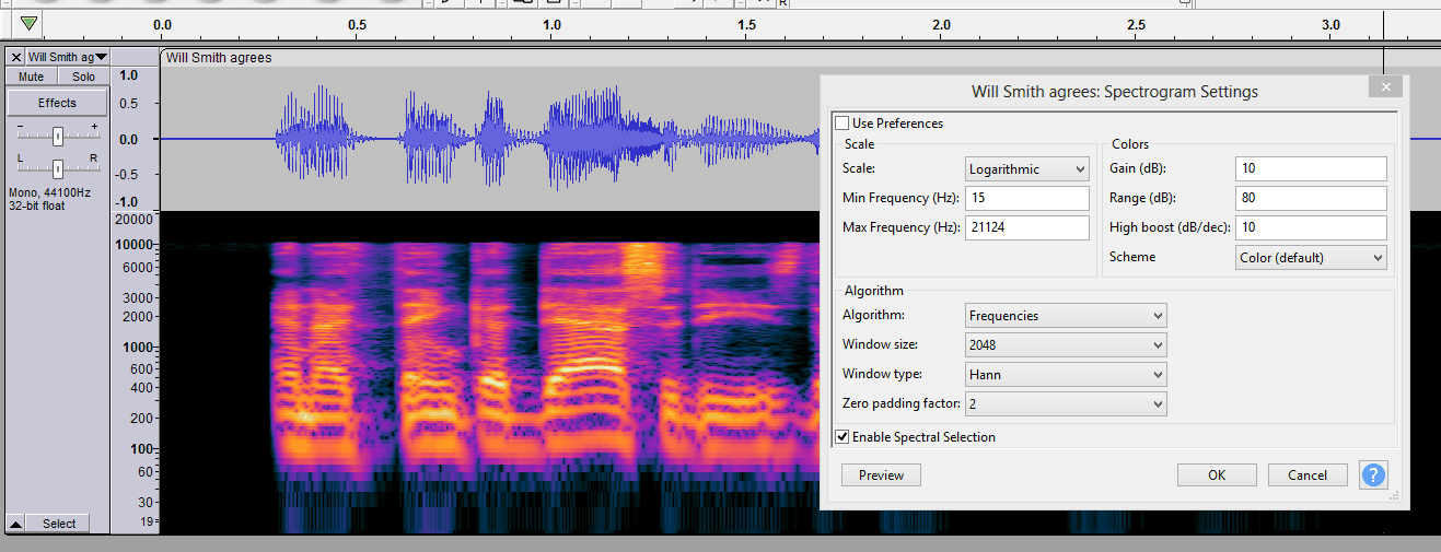

I am editing the audio for an audiobook, so that the audio matches with the text. It is difficult to know where to place the insertion point tomake the cut between words that run together . My results have not proven to be acceptable; I hope someone can steer me in the right direction. I am on a macbook air (2020), running os ventura and audacity 3.2.4. Thanks. Hank
Multi-view: waveform & spectrogram

The best solution is to replace sentences instead of words.
If you must chop-up a sentence it’s best to fade-out, fade-in, and splice with a short crossfade (overlap). The fades/crossfade should be just a few milliseconds. Long -enough to be smooth but short-enough not to be noticed (hopefully).
