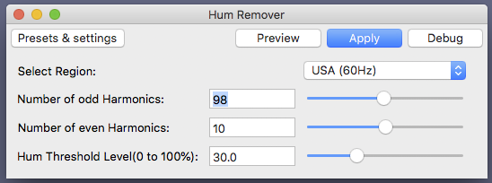

That’s award-winning US power hum and buzz. Somebody has a microphone with a broken wire in the cable, a dead shield, or a bad connection. I wouldn’t be shocked if you touched the microphone and the problem got a lot worse. It’s also possible to touch the microphone and have the problem vanish completely. That’s what an unstable microphone will do.

Effect > Hum Remover. USA. Experiment with the three values.

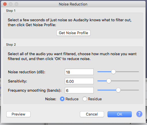

and the perennial favorite, Effect > Noise Reduction.
Noise Reduction is a little magic because it’s in two steps. Drag-select some pure noise. No voice. Effect > Noise Reduction > Profile.
Then select the whole show.
Effect > Noise Reduction > Three Values > OK. I think 18 for a reduction value is too high.
All these tools affect the quality of the voices. It’s up to you to juggle the noise reduction versus the voice quality.
Quick note. I was expecting Effect > Hum Removal to take all this out. Since it didn’t, I suspect that wall power hum isn’t the only problem. So combinations of tools is the answer.
