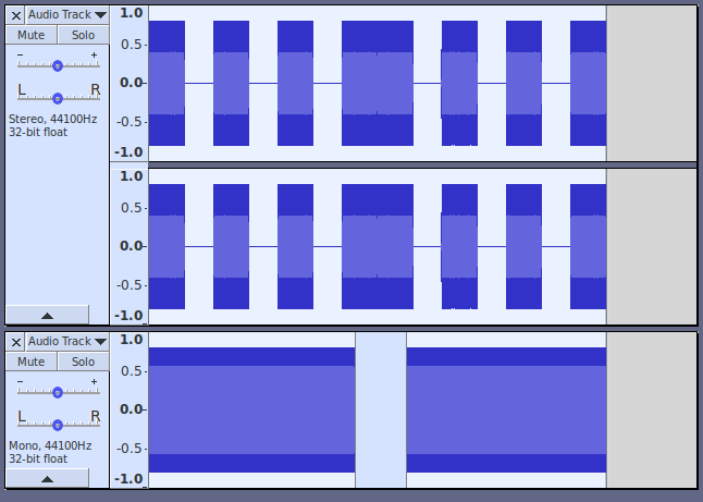

One possible workaround is that you can “shield” some parts of the recording from being truncated by generating some sound into another track to overlap the parts that you don’t want truncated. For example, to truncate only the 4th gap in the stereo track below, I have generated tones into a mono track that overlap the other gaps:
Then, selecting both tracks and applying Truncate Silence, the first three gaps and the final three gaps are “shielded” by the tones in the mono track:
