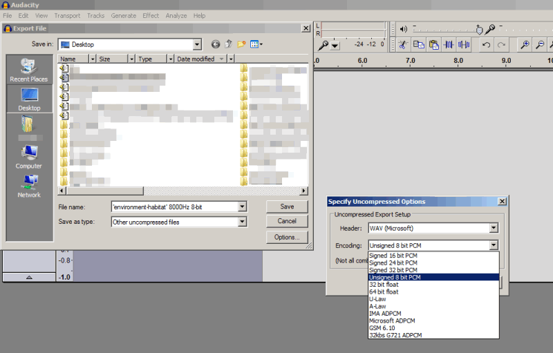

Click on “Options” when you save as “other uncompressed files” and you can select to save as 8-bit depth WAV …
If you want to minimize the file size you’ll need to reduce the sample rate from the default 44100Hz, to something lower like 8000Hz, e.g. attached.
As you mentioned there is a trade-off between quality and file-size, the smallest file sizes are the most distorted, (this is inevitable).
To achieve that I think you are going to have to use 4-bit depth @ 6000Hz, which will be coarse.
