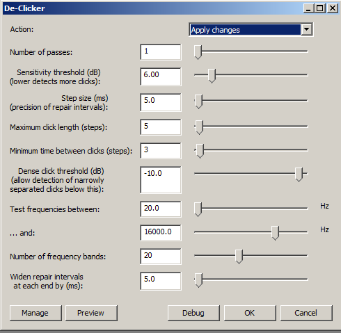

The only practical solution is to reduce the thumping beat, rather than remove it completely.
If it was totally removed there would be silence, not melody, where the thumps were.
The thumps can be reduced using the “DeClicker.ny” plugin for Audacity here.
Guys, thanks! that was i wanted.
