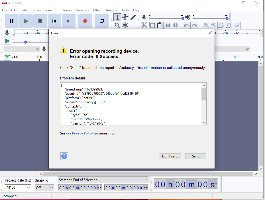

I have looked at a couple youtube videos and also read the manual but with Audacity open nothing is listed in the drop down menu next to the mic icon. When I click on the Rec button this is the error message in the image attached so I’m stuck, help please?
See the green box in this FAQ: https://manual.audacityteam.org/man/faq_recording_troubleshooting.html#vista_7

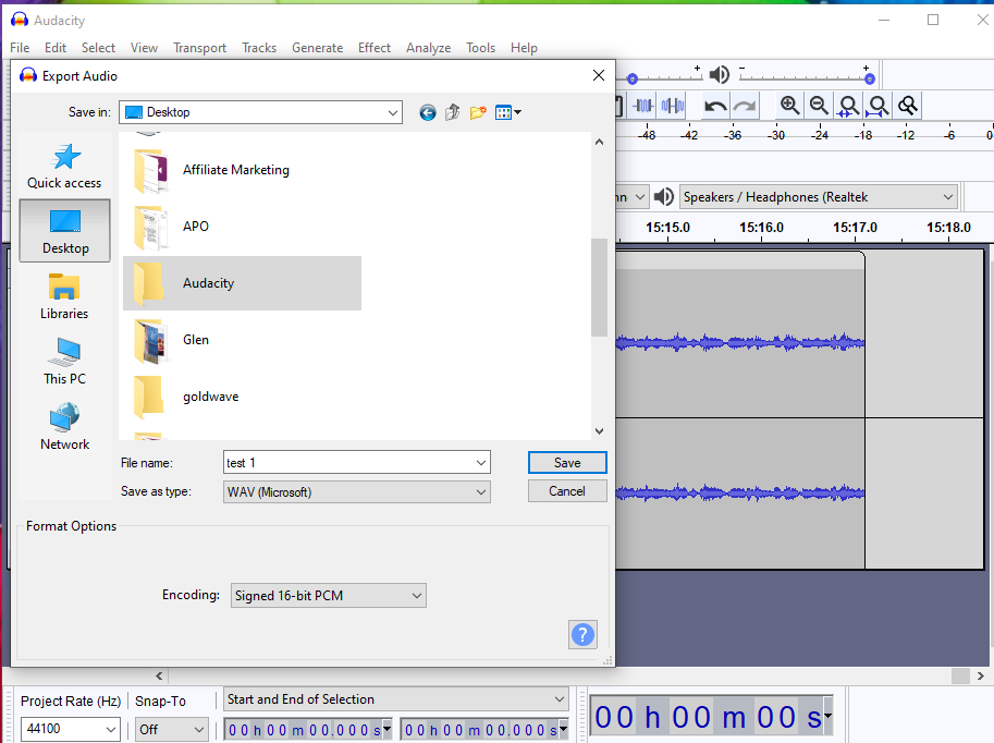

Thanks Steve, works. If I may ask for your advice, when exporting as wav, these are the settings I have used, would you recommend any better settings and after that what would you recommend I do to get the best audio for saving as mp3 files please?
Audio CDs are 16-bit, 44.1kHz. That’s generally better than human hearing and much better than cassette (or anything analog) so it’s good-enough for anything. If you’re burning a CD that’s what you’ll want to use. If it makes you “feel better” you can use 48kHz. That gives you a little more high-frequency range and a proportionally larger file but you’re not going to hear a difference. Up-sampling doesn’t gain quality so if you want a higher sample rate you have to record at a higher sample rate to begin with.
MP3 is kind of tricky… The (theoretical) best setting is 320kbps constant bitrate, and joint stereo. Personally, I use “V0” joint stereo, which is the best variable bitrate. Variable bit rate uses a lower bitrate with easier-to-compress sounds for overall smaller files. And with variable bitrate you are choosing the quality and the LAME encoder chooses the required bitrate moment-to-moment. (Joint stereo is always the best choice for stereo files because it always makes the best-use of the available bits.)
Longer answer… As you may know, MP3 is lossy compression. Information is thrown-away to make a smaller file. But it’s “smart” and it tries to throw-away sounds that you can’t hear because they are masked (drowned-out) by other sounds. A good quality MP3 can often sound identical to the original. There is no easy answer because some sounds are easier to compress than others and some people are better at hearing small compression artifacts.
The bitrate (kbps) is kilo_bits_ per second. There are 8-bits in a byte so you can divide by 8 to get the file size in bytes-per-second (excluding any embedded artwork adding to the file size). Lower bitrates give you more compression (more data thrown away) for a smaller file and potentially lower quality.
But… MP3 is always lossy and every sample will be altered to some extent, even with the best settings. We can only say it’s “better” if it actually sounds better. At higher bitrates, there can sometimes be other side-effects unrelated to “throwing-away” data so the sound doesn’t get better with a higher bitrate. Or more often, something like 192 or 240 kbps sounds identical to the uncompressed so we can’t say 320kbps is “better”.
