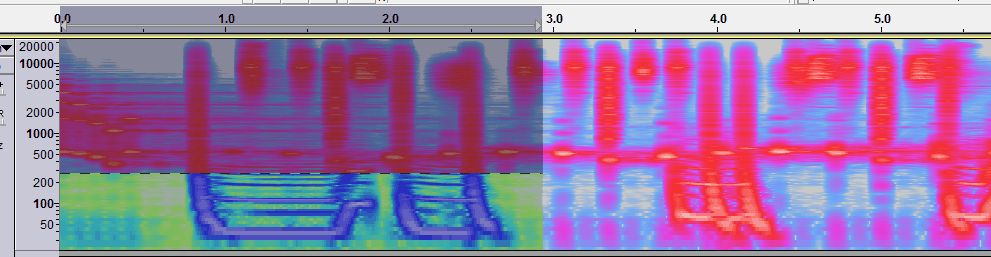

Spectrogram display on Audacity could show when the bass noise occurred, but not how loud it actually was.
