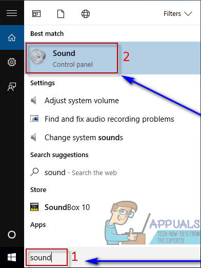

Lyndon, also try this:
Right-click on the speaker icon in the lower right-hand corner of your screen. Select “Sounds”, then click the “Recording Tab”. Click on “LIne-in”, then “Properties”. Then select the “Listen” tab. Is the box “Listen to this device” selected? Try de-selecting it.
No, I don’t know if there is any way for Audacity to control this behavior directly. :frowning:
I hope this helps. :smiley:
Thanks for these suggestions. I tried this. The choices were labelled a bit differently, but I think they were basically what you were referring to. I selected:
Sound — Input — Line in — Device Properties
Advanced device properties — Listen [tab]
The Listen to device box was NOT selected, so I didn’t change anything, just backed out of these Sound settings windows.
