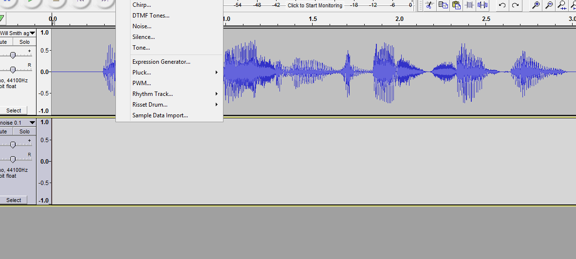

Try some Distortion Effects.
TalkBox is a high-resolution vocoder.
Talkboxing with off-white noise makes voices sound hoarse.

  3. Created voice in mono track and added white noise with 0 amp in another mono track
  4. Mixed and rendered both track together

You have to make a stereo pair before applying the MDA Talkbox effect…

You have joined the tracks correctly, it seems MDA Talkbox has not been applied.
I have applied it using Audacity2 running on Windows (I don’t speak Mac).
MDA Talkbox is an old 32-bit plugin, it will be incompatible with 64 bit Audacity.
