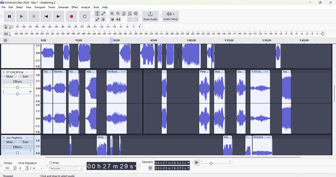

Iâm having the same issue with pre-mixed playlists I create in Audacity - screenshot attached ~30-40 tracks over 1.5 hours - for a sound healing practice called Innerdance. Normally it hasnât been an issue but got a 2 day event coming up so have hired some RCF PA speakers x2.
Normally I create the mix, importing tracks Iâve downloaded in 320kps, often they are fully 0-1 on the waveform and have clipping when I load them into Audacity - is that normal? or Iâm getting bad quality files? So I adjust them down manually with the envelope tool, plus mix them together between songs, then export the mix as a WAV file and play through media player.
With all the extra âhead roomâ / volume available from the PA speakers versus my normal little sound bar I use, I am finding it a lot clearer when the volume on certain tracks is louder than others - normally this wouldnât be as noticeable.
Ideally I just want to hit play and forget about having to adjust the volume during the session - i.e. never getting too loud for people, but also for the quiet / gentle sections of delta sounds to not be too quiet.
âLoudness Normalizationâ feature would seem to be what I need, but I ran it over all the tracks and it didnât seem to do anything?
Should I manually adjust all the tracks with âNormalizeâ to -1dB, or something lower like -3dB ? The speakers have so much punch everything is at half on the mixer, speakers etc. so plenty of room to turn the volume up if I know it isnât going to get too loud at some point.
Thanks for your help in advance, much appreciated ![]()
It can be normal⌠MP3s are âmore complicatedâ because the lossy compression changes the wave shape making some peaks higher and some lower. So even if the original wasnât clipped, the new-highest peaks can go over 0dB. And, MP3 can go over 0dB without clipping but you will clip your DAC if you play it at full digital volume.
Many-many of my MP3s âshow redâ in Audacity, but thatâs because the MP3 peaks go over 0dB but they arenât really clipped.
Personally, itâs not something I worry about. As far as I know, if you do clip your DAC, the slight clipping isnât audible and if youâre playing MP3s youâve already decided to use a lossy âimperfectâ format.
And some CDs are clipped during mastering to âwinâ The Loudness War. If you lower the volume they will no-longer âshow redâ but lowering the volume doesnât remove the distortion.
WAV files ARE limited to 0dB so if you are making WAVs from MP3s it IS a good idea to lower the volume a bit. You could use the Limiter to do it automatically. I recommend the older limiter because it actually allows you to set the limit to -1dB or whatever you want (Effects â Legacy -Legacy Limiter).
It should do something depending on the loudness setting you choose. The âproblem isâ, you may not know where to set it and it doesnât check for clipping so you can end-up pushing the peaks into clipping. ReplayGain and related DO check the peaks and by default so for tracks that need to be boosted, they will only adjust-up as much as possible without clipping.
NO, because regular normalization adjusts for a target peak level which doesnât correlate well with perceived loudness.

Regarding ReplayGain via a media player, will that work on the Audacity mix? I guess that is more for individual files one by one? If I export a single 1.5hr mix I assume it wonât do anything?
Ok thanks. Is there any point exporting in WAV, I know it is âlosslessâ thatâs why I do, but yes all inputs are MP3. If I export in MP3 would it be any different? Anyway the initial issue with the volume Iâve noticed is playing straight out of Audacity pre-export, which I guess exporting might add more changes to how it sounds?
I will try and use the limiter on the mix instead of normalise and see what happens. I did normalise the âloudestâ tracks last night to -1dB, even the ones I thought I had âbrought downâ enough and could see it adjusting them further down, I havenât listened to it yet through the speakers so maybe those tracks will be too quiet
I asked on another forum and somebody said âIf loudness normalization doesnt work for you then it means you are working with tracks with very different dynamic range.â - which is probably true as we have quite loud/powerful tracks dropping down into periods of very relaxing delta type music.
Would you agree or maybe I havenât done it right? I just selected the entire 1.5hr mix, including loud/quiet parts + voice/spoken quote sections etc. and applied âLoudness Normalizationâ which yes when I looked back at the mix havenât seemed to do much to the waveforms, but maybe I need to play it through the speakers and see if there is a difference?
Thanks for your help ![]()
Right, if you have one long file it will adjust the whole file by the same amount.
The individual tracks have to be level-matched first. Itâs too late unless you want to start over. ![]()

Oh and I used -9LUFs on Loudness Normalisation, as a quick google a Mastering website referenced that as what is used on CDâs and I didnât want to make my mix too quiet, but maybe that was to win the loudness wars as you mentioned
But maybe I should try with -14LUFs which it seemed to say is Spotify settings for upload which is where most of the tracks came from or the default -23LUFs? and then just turn up the speakers if I think it is too low?
âThe individual tracks have to be level-matched firstâ - can you send me a good link with info for doing that? I assume you mean using Mp3gain or similar upfront before importing the tracks into Audacity? Is there anything I can do in Audacity? The mix is still in there but yes I donât really have time to import them all again and remix
ReplayGain Iâm sure looks good but doesnât really work for mixes right? thats for individual tracks one by one, Iâm chopping changing etc.

Thanks, can I use ReplayGain or Similar in Audacity though the way I want to make a mix, or I need to adjust the tracks first then load into Audacity and mix?
I donât really want to just have a playlist of 1 song after the other in a media player with ReplayGain to level them, for that I could just use Spotify like I have before but was aiming for more immersive soundscapes now with multiple layered sounds etc
Thanks again for your help Doug, much appreciated ![]()
So what do you think is my best option to make this playlist easy to move through without lots of manual volume intervention? Session is tomorrow so I have some time for small adjustments but canât redo it all
Use limiter to -1dB on all the louder tracks? with hard limit setting, others/gains set to 0dB and 10ms hold?
Or loudness normalise to something like 14 or 16LUFS on the louder tracks, leaving the quieter ones alone? 16 LUFS sounded fine on a louder track, 23 LUFS was definitely a lot quieter without turning the volume up
something else?
Per my screenshot, mix has ~40+ songs mixed
