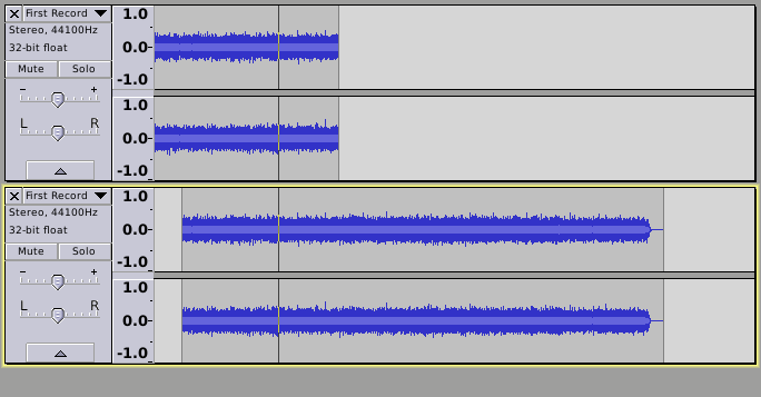

You should now have something similar to this:
and zoomed out a bit:

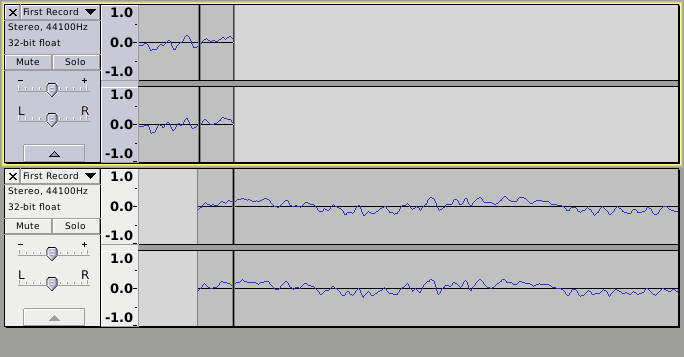

From the zoomed in view, make a very small selection in both tracks and press Ctrl+i to create “split lines” like this:
Now you can use “Edit menu > Remove Special > Split Delete” (shortcut Alt+Ctrl+K) to delete the end bit of the first track and the first bit of the second track. The reason we use “Split Delete” rather than the normal “Delete” is so that the remaining part of the second track remain in the same place. To select an audio clip with the mouse, just double click on it.

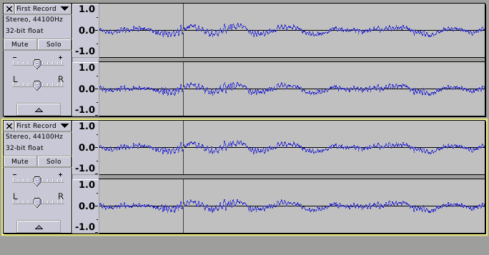

You should now have something like this:
Finally, select the tiny little clip (end of the first track and start of the second track) and apply the “Crossfade Tracks” effect with the default settings.
