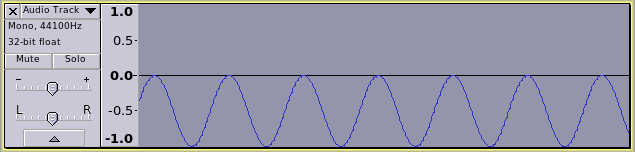

0 dB is equivalent to any sample having a value of +/- 1
This rather strange looking waveform has a peak amplitude of 0 dB, because the most extreme peaks (peaks can go down as well as up) are at -1.0
“Peak amplitude” is one common measure of the “vertical size” of a waveform. Another commonly used measure is “rms”, which is a kind of “average vertical size”.
For most commonly used audio formats, 0 dB is the absolute minimum or maximum value possible. This is because most commonly used audio formats use integers (whole numbers). For example, for “signed 16 bit audio”, each sample has a numerical value between -32768 and 32767 (binary values 000 000 000 000 000 and 111 111 111 111 111).
The numerical value is then divided by 32768 to give a sample value in the range of -1 to +1.
