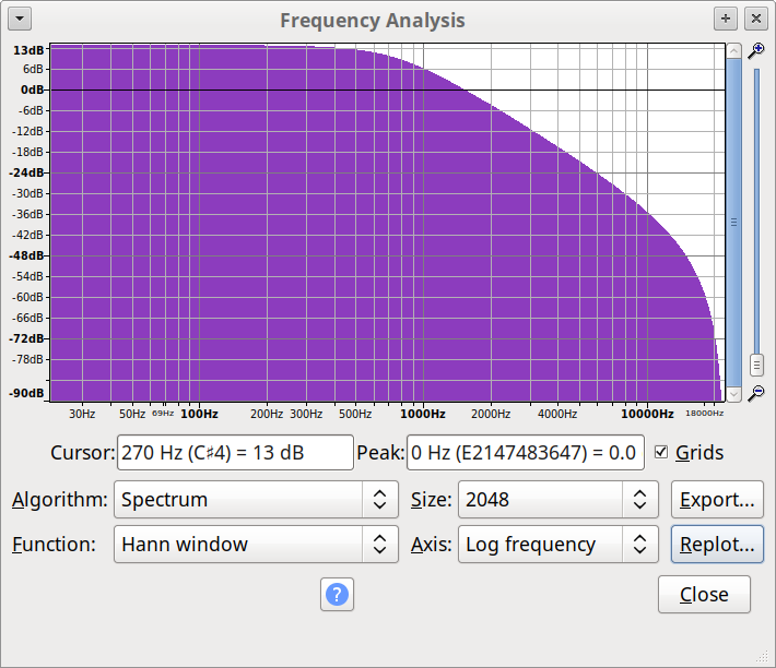

Perhaps you used different settings.
This is the effect of a 2nd order (12dB/octave) Butterworth low-pass filter using “Classic Filter”:
and the is the effect of a 12dB/octave (2nd order) low-pass filter using “Low-Pass Filter”:

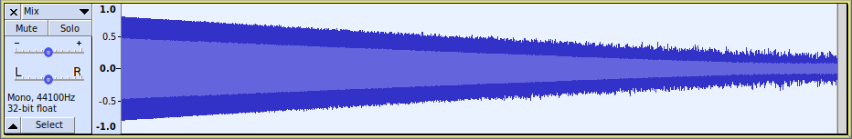

I can’t explain that. It does not do that for me. :confused:

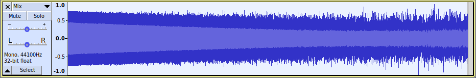

I would expect it to gradually get lower because the filter removes some of the audio, like this:
If you want to keep the amplitude about the same at the end, Amplify the filtered track before mixing.
So the steps are then:
  1. Duplicate the track - Select the track, then “Edit menu > Duplicate (Ctrl + D)”
  2. Apply the low pass filter to the upper track
  3. Fade in the upper track
  4. Amplify the upper track so that the level at the end is back up to the original level
    5 Fade out the lower track
  5. Select both tracks
  6. Mix and Render
