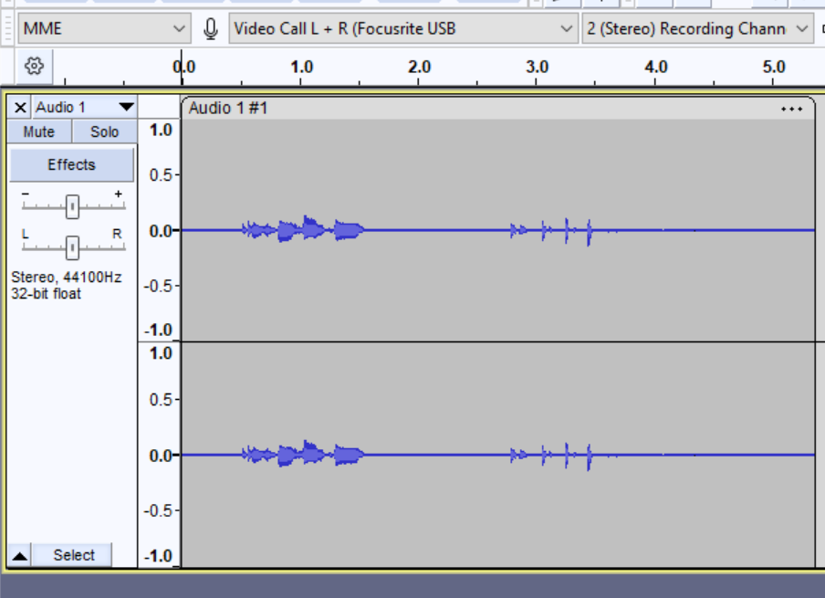

I have followed all the troubleshooting steps in this post but can’t overcome this issue. Here is my setup:
  • Focusrite Vocaster Two interface
  • Shure MV7+ microphones connected to Vocaster with XLR cables
  • Shure headphones connected to Vocaster
  • Audacity 3.6 on a laptop
The mics don’t record on separate tracks and I hear both mics in both headphones. In other words, both mics record on both tracks. There is no way to separate the host and the guest on to separate tracks for editing.
Audacity>Preferences>Recording>Overdub is not selected
Control Panel>Sound>Focusrite is set to 2 channel recording
Help!
