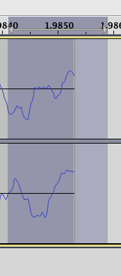

Tight musical editing has restrictions in order to make seamless cuts. The first illustration is the end of cut 2. The blue waves (magnified greatly) must be at zero (on both clips) for the join not to make noises. This one is not. If you joined the end of this clip to almost anything else, it going to make a click or pop.

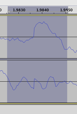

The second illustration is of two different clips neither of which were at zero at the join. That’s the straight, flat, rising slice in the illustration at 1.9837. That will tick badly.

I see serious data error gaps (illustration). That short flat spot isn’t supposed to be there. Is that what you’re talking about? Is that at an edit point?
Hi Koz.
That is what I am talking about, the edit points. I can’t find the exact times since it goes by so fast when I listen to it, but I know they are in the same intervals as the duration of segments 1-3. By zooming in, the flat parts in your picture therefore must be what I am talking about. I will try the cross over method or the find zero crossings method. Thank you for your help.
