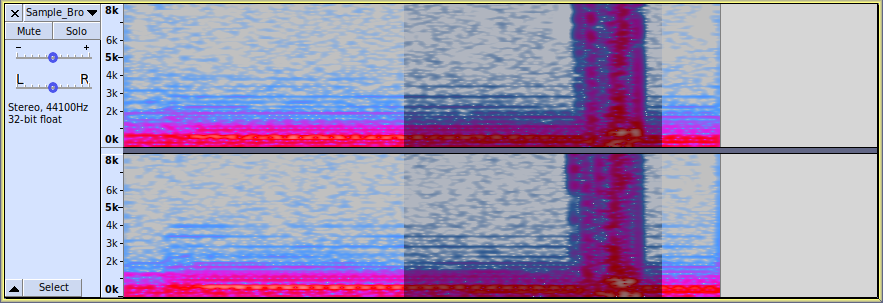

It’s clear from the visualised audio track where the culprit is:

This “EZ-Patch” plug-in: EZ-Patch
The result isn’t perfect, but in my opinion it’s a big improvement:
Thanks, Steve. I just installed the EZ-Patch plug-in and it does wonder. I’ll need to do some more testing with a headset.
Did you use this plug-in for your posted fix?
Yes.
I used track spectrogram view so that I could see more easily where the damaged section occurred, then selected that plus enough audio before to make the repair.
