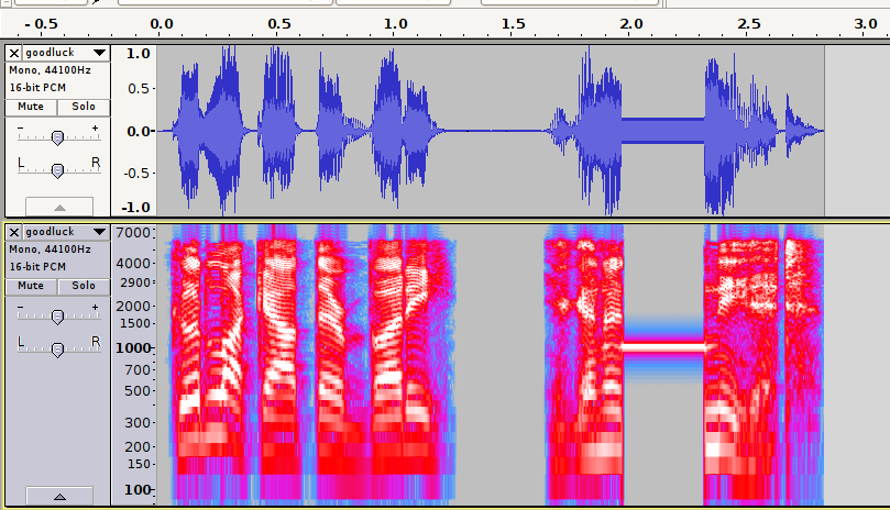

The typical censor bleep is 1000Hz sine tone, which looks like this on a spectrogram
Thank you, Trebor!
