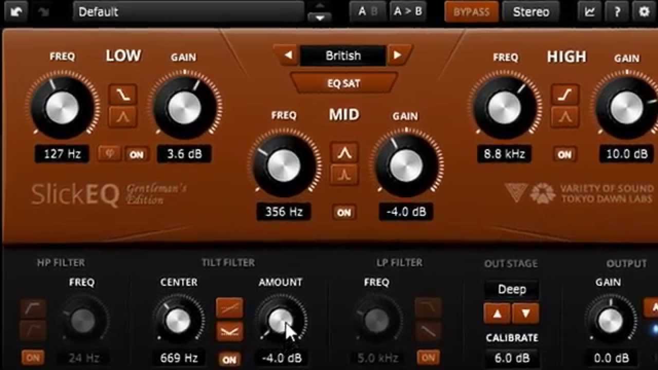

That’s a bandpass filter. There are free plugins which will do bandpass in real-time, e.g.
NB: Only 32-bit plugins work in Audacity, (even if your computer is 64-bit)
