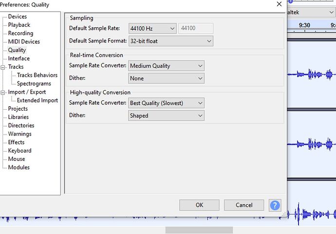

What settings do you have in “Edit menu > Preferences > Quality”?
[/quote]
Ok…
