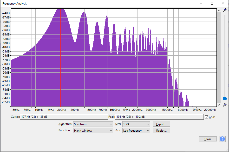

Yes, so here is the Analyze Spectrum for a recording of a real G-string on a guitar:
The lowest (and loudest) peak is at G3=194 Hz. The other peaks are harmonics and are typically smaller and are typically found at octave intervals (194Hz x2, x3, x4, x5, etc.) In this particular case, the G4 peak happens to be at 395 which is 197.5x2. Note with 440 tuning, G3 should be at 196Hz.
Note that the real world does not always conform to our expectations. :grinning:
