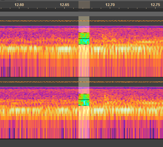

That’s not going to work for footsteps. Spectral editing is your only hope: it’s like photoshop …
spectral edit2
A tedious painstaking process.
