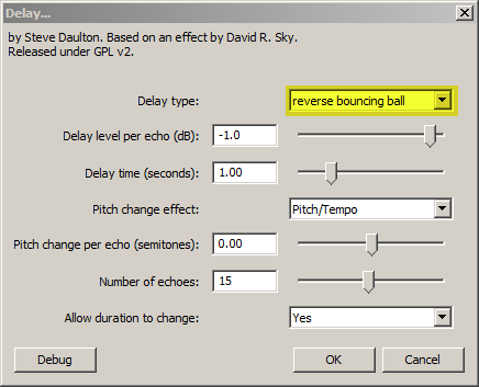

There’s a quicker way …
Select all the applause you’ve got then apply Audacity’s Delay effect with “reverse bouncing ball” selected …
Input a delay time which is in the range a third to a half the duration of the applause you have, and ensure “allow duration to change” is “Yes”.
[ A second simultaneous applause track with a different delay-time will add more realism ].
