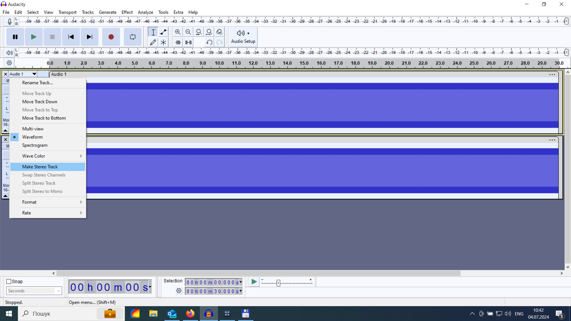

Mono track will automatically be sent to both channels by audio hardware. But if your client requires a stereo track, it’s very easy to do. Select the mono track, press Ctrl+D (a copy of your track will appear in the project), Select “Make Stereo Track” in menu of first mono track
Hi Victor,
I have a problem following your instructions. I successfully created the duplicate track and selected it.
I cannot select “Make Stereo Track” from the menu because this option is disabled (greyed out).
Can you tell me what I’m doing wrong or how to get around the problem?
I’m using Audacity version 3.5.1.
