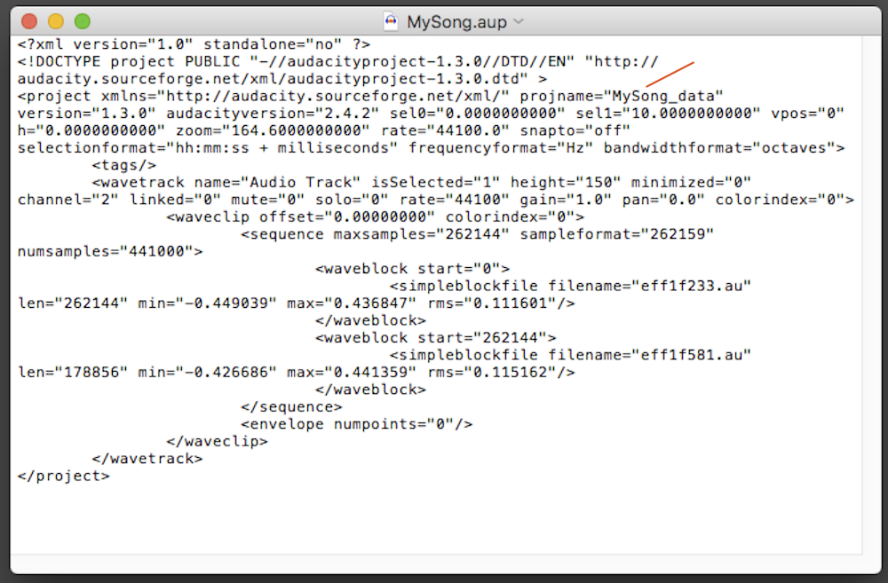

If you force your computer to open the .aup file as a text file (TextEdit in my case), you get something like this.
Fourth line down, to the right (marked), the aup file points to the _data folder it is expecting. This is a good way to make sure the names are correct. All the names have to match.
Close everything. Double click the .aup file and the show should open in any version of Audacity. If it doesn’t, then something is damaged and the show may be permanently gone.
