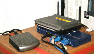

Probably what you’re really looking for is a USB to network adapter and then connect the turntable to your home network. The turntable becomes a network service.
That’s how my off-air television tuner works. It has an IP number and an ident. The TV software in my computer knows how to go looking for it. If it will pass television video, it should have no trouble passing stereo.
