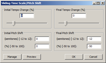

You can do that using “sliding time-scale / pitch shift” …
But you’ll have to repeat (Ctrl+R) the effect 2 or 3 times though.

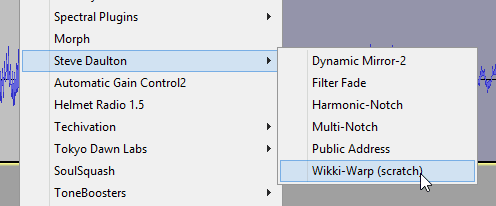

@steve It’s working for me in Audacity 3.3.2: It appears in your eponymous folder …
wikki in eponymous
Works great on 3.6.1, Thanks, @steve!
