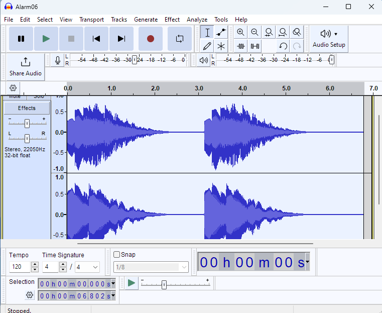

If I increase amplification from 12.149 dB to 12.2 dB and get this effect.
In fact, I don’t need to increase amplification at all. If I just click Apply in the first picture, I get this huge amplification. I cannot get any smaller amplification regardless of what I do.
What am I doing wrong?
You are misunderstanding something… You are increasing by 12dB which is an amplitude increase of about 4X, not to 12dB.
Also, 0dB is the “digital maximum” so digital dB levels are usually negative. 0dB SPL, (acoustic loudness in the air) is approximately the quietest sound than can be heard so SPL levels are positive.
Audacity has pre-scanned your file and its defaulting to whatever change is needed for "“maximized” 0dB peaks… It’s indirectly telling you that the peak is currently -12.149dB.
Change 12dB to something like 1dB and you’ll get a small (1dB) increase, making your peaks -11.149dB. Enter -1dB and you’ll get a small decrease.

I assume that the values shown by Audacity are relative. Anyway, the 0 dB shown by Audacity cannot possibly be SPL 0 dB.
If I apply 12.149 dB amplification to my signal, the new amplitude after amplification will be 0 dB. What is 0 dB? As you are saying, in a relative measurement, you must have a reference to make values meaningful. So 0 dB for Audacity is some reference sound level. What is it?
