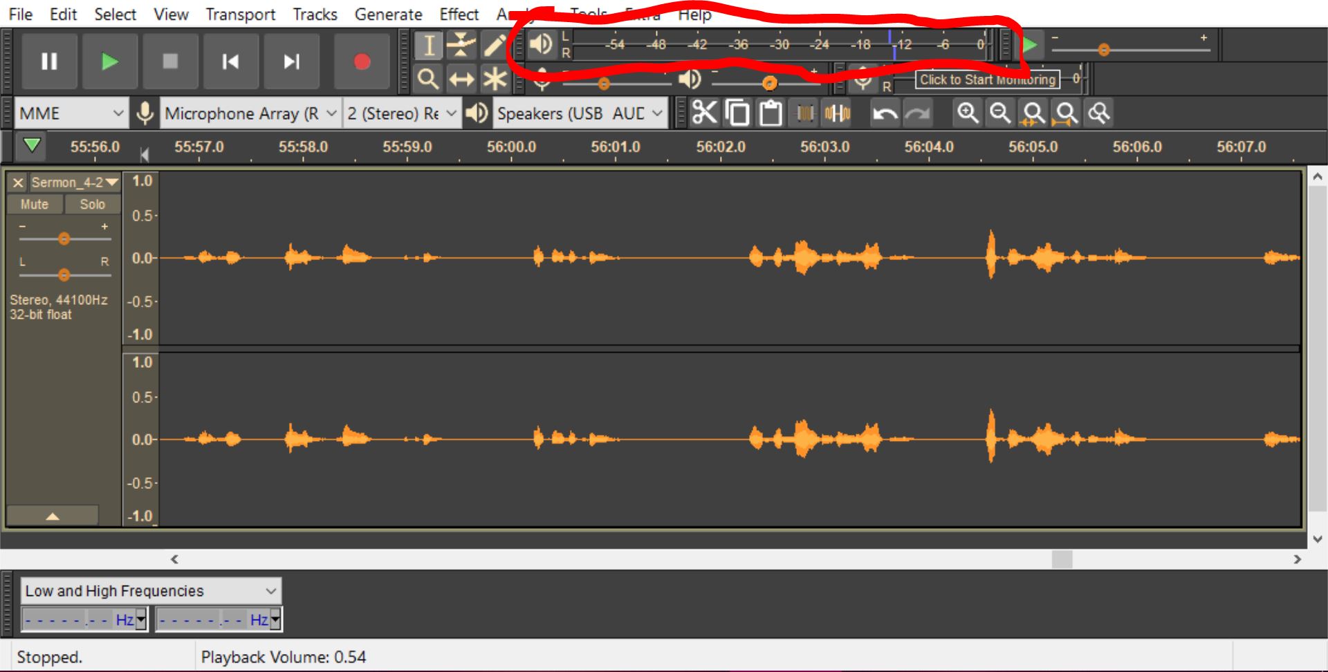

But can you see even a small little bit of noise when you highlight a silent place and then play it? Even though it doesn’t show up in the waveform, and even though I can’t hear it, I can see it in the playback level monitoring tool. So I remove the noise FIRST. Then after I use compressor (which evens out the sound somewhat and amplifies most of the recording), I find more noise so I run noise reduction a 2nd time.
I’m attaching a screenshot with the playback level monitor circled. You can see my waveform in this particular part of the original wave file is not very loud. You can also see that the silent part LOOKS fine on the waveform. But when I highlight a silent section, the green bars show up in the playback level monitor. (Sorry; I cannot get a screenshot showing the green bars.) I try to find a place with the maximum noise and run noise removal before doing anything else. Then, after running compressor, I repeat the process with the noise. This seems to minimize the distortion if there happens to be an even worse section when he gets too far away from the microphone. I’m using an older version of Audacity and also have changed it to dark mode, so my screenshot may look a little different than your screen; however, you should still have the playback monitor tool somewhere.
