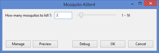

The magic-ingredient you’re missing to remove the background noise is Mosquito Killer on 2 to get rid of the faint constant whine …
IMO Use Noise Reduction first, then Mosquito Killer set on 2.
