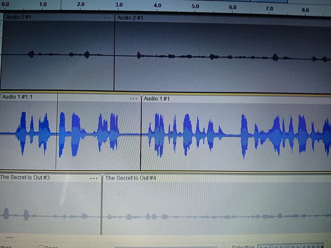

Okay, will do. Yes, I also have sound effects in some of the chapters and some are spoken word. My chapters are MP3 files. I attached an image because someone said that it could be the noise when it’s not the talking parts.
Koz,
I’ll post some of my work, but will everyone be able to hear it or will it go directly to you only? I perfer only you. ![]()
I think you can click on the blue “K” in the ball. That should give you the forum messaging connection. The upload icon is still the bar with up arrow.
Post here on the open forum when you post the private message. I don’t get the notices.
Traditionally, ACX didn’t much like Radio Theater. The best you could do is brief introduction music and then spoken word for the rest of the chapter. They may have changed that.
There is one really bad news item. I strongly recommend producing your Edit Master Chapter files as WAV (Microsoft) and not MP3 or aup3 files. Audacity aup3 files, while containing perfect sound, can be brittle and easily broken; and you can’t edit an MP3 file.

Before I get all Debby Downer, let’s see what’s wrong with the chapter.
It’s possible the sound effects are what ACX doesn’t like. Again, traditional audiobooks (if you bought any) consist of the announcer introducing the work and then talking in a pleasant, entertaining manner for a chapter. Repeat.
