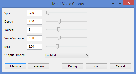

I think chorus effect is what you’re looking for.
( NB: It is necessary to duplicate a mono track into dual-mono before applying a chorus effect ).

If you turn the speed to zero you lose the chorusy effect,
and just get delayed “100% acoustically accurate” versions left & right …
NB: you must duplicate a mono track, & join them to make a stereo pair, when using any stereo-effect.
