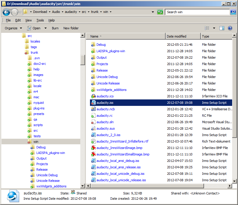

In the “win” directory of the source tree, you’ll find the file audacity.iss:

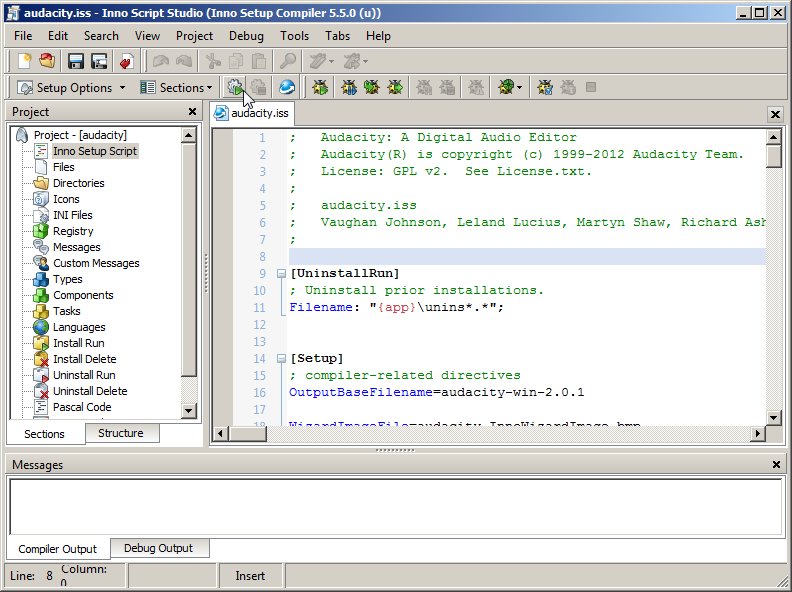

Double-click on it and the Inno Setup installer creator will start up:
Click on the compile button (the button the mouse pointer is resting on in the picture above) or press Ctrl+F9.

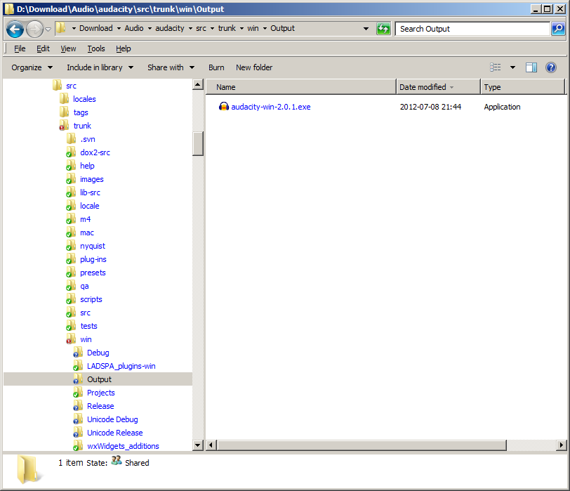

Inno Setup builds the Audacity installer and places the result in the winOutput directory:
That’s all there’s to it.
