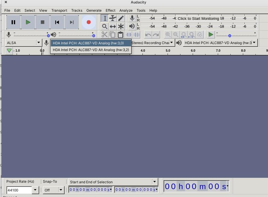

I have Audacity 3.05 running on Elementary OS Odin (Linux) and I have an Allen and Heath USB mixer and a USB mic plugged in (sometimes). I’ve done the rescan thing in the transport menu and restarted the comp quite a few times but it seems like every time I try and choose inputs and outputs it’s different. Sometimes it’s obvious what’s what, sometimes I have a list of numbers, right now there are 24 entries in the input drop down
But it’ll probably be different next time. It’s using ALSA. By choosing every entry one at a time I have found combinations that work but I can’t do the trial and error thing every time. Sometimes I get an error about mismatched sample rate (-9997).

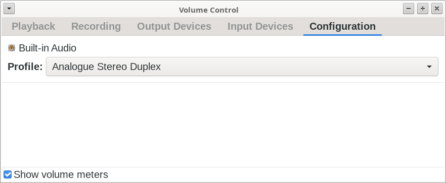

In the “Configuration” tab, what is selected?
Sorry for the late reply.
Wow, you’ve go a lot there.

The next thrilling installment of my Audacity input/output troubles is here! The I/O situation has settled down now and despite gadgets being connected or disconnected they stay as shown in the pictures.
No amount of ‘scanning audio devices’ or restarts has any effect. Are there any cryptic commands that can be typed into the terminal to move things along?

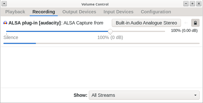

I don’t think I can help you. Your computer has an extremely complex audio setup with SIX separate audio devices.
This is what a more typical configuration in Pulse Audio looks like:
I have disconnected all but the Line 6 Helix and the USB mic, this is the problem, the I/O drop downs don’t reflect the physical devices connected, in post 1 I had 24 devices connected according to Audacity! The Helix has never shown up in Audacity despite being my only audio interface now and the mic has put in an appearance this morning for once, but it won’t be there when I need it. Even the number of entries for the HDA intel PCH thing changes from one day to the next.
