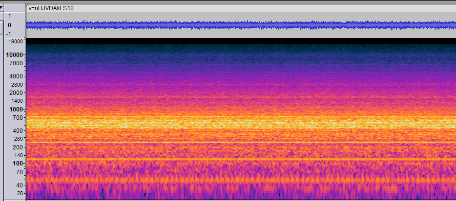

Hello! I am very new to audacity, and I wanted to edit this white noise on youtube for my own use during power outages. However, I can’t stand the very low mechanical hum that plays under the fan sounds, which my real machine does not have. I can’t exactly use noise reduction, as there’s no point where that noise would ever be isolated to take a sample. Thanks so much.

That YouTube video (v=nHJVDAkLS10) is not really white noise: it has resonance ~500Hz

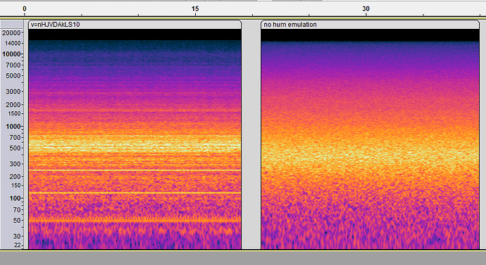

[emulation without hum. Loopable]

Equalizer is too blunt a tool to remove hum. Spectral editing is more precise …
