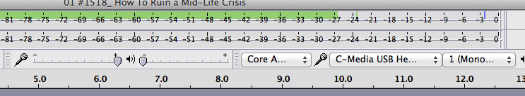

Like this?
My Audacity recording sliders do work with this device, but it’s not the latest Audacity. I may have to come back to this. I have to leave for a while.
Nope. Not quite the same thing. Mine is a C-Media USB Headphone Set. But. It does have a working volume control in Audacity 2.1.0. Attached. The Audacity volume control slider does what it says and Apple (upper left desktop) > System Preferences > Sound > Input also shows the C-Media device. The System Preferences volume slider follows the recording volume control in Audacity.
Does yours work that way?
