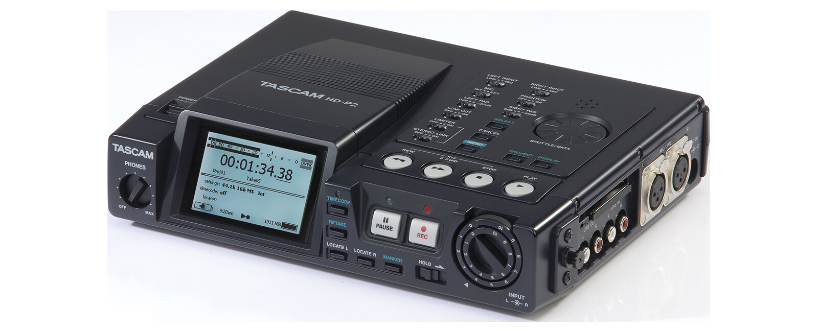

Thanks for picthing in. I’m not quite sure what you need e.g.the camera info for, but it was a P2 recorder. I know why the sound gave me problems (I knew that even while I was shooting it), and now I’m just trying to save it the best I can. Let me know what other info you need, and I’ll make sure to provide it. Sorry about the rar-format. I’m on a pc and use it every day - guess I should have zipped it.
So it’s one of these. Cool. Nice recorder.
I ask these things because if you knew everything about the problem you wouldn’t be here and we know nothing about the problem or the setup and it’s not unusual for us to tighten up the license plate bolt.
